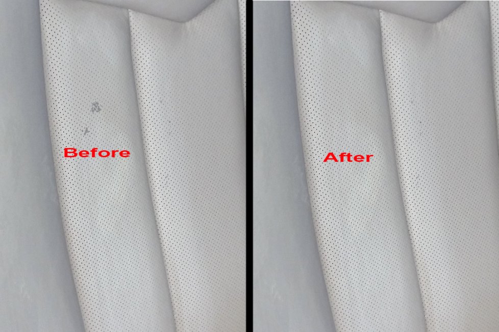

Last week found me with a wad of bubble gum stuck on the passenger side seat. I only saw it after a 75 mile trip and it had already hardened to an extent.
An ice cube applied to the stuff helped me to get most of it off, but in doing so, I managed to remove the coloring (shale) in a few small spots. To say I was ****ed doesn't do the feeling justice.
After an internet search and looking at a LOT of solutions, I decided on Magic Mender which offered Cadillac colors and if, upon arrival, it was the wrong color I could send the dye package back and exchange it for a different color at a reduced price. It arrived today, and following instructions made the repair. In the bottle it's darker, but after using the sponge applicator and feathering the dye out, it's as perfect a match possible. After applying you use a hair dryer for faster results, which I did.
The pictures I took show before and after application. It still has to completely dry, but I believe it's a home run.
I also applied this stuff to the plastic (shale) door sills where there were some scuff marks that I just couldn't remove, and the dye covered them to appear like new.

I need some touch up on my gear shift handle what color for shale did you pick that was prefect?
In my case, the number for the 04/06 models was Shale, #6985
On my laptop screen it really looks dark, I looked at it on my desktop monitor that is color calibrated for Photoshop and it's slightly lighter.
With some trepidation I put a spot of it on the side of the seat before attempting it on the spot and after a minute or two of a hair dryer, it was pretty much spot on. I knew I could send it back, but it dried perfectly and today, 24 hours later, the fix is damn near perfect. All I got was just the color flex itself, not the repair kit. I have seen a couple of XLRs that needed that repair kit though, as the owners just didn't take care of the leather properly
Thank you I'll be ordering some, a tip I've learned that works well at for cleaning the leather is Magic Erasers, but also found that a few years ago I had a guy spray match part of the seat and later, had that panel replaced, he had some over spray on the seat area an Magic Eraser had removed the overspray off that area! So it may remove it off your spot!
Thanks, but the actual color was stripped off the leather. Just a couple of ugly dark brown spots that stood out light a searchlight. The ColorFlex stuff filled in the color and I feathered it out to blend in better.

Rexster, how has this stuff held up over the last couple of years? Got a well worn SUV seat we’re thinking about fixing.
Still there, no different than that result almost 3 years ago. Haven't had occasion to use it again, but probably will redo the kick panels on the doors when the car comes out of the shop
