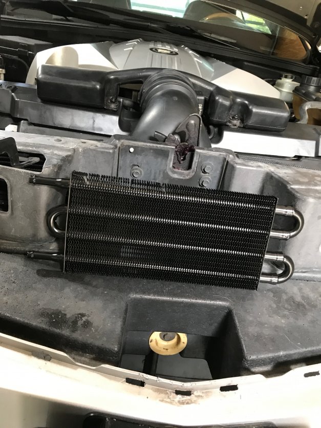

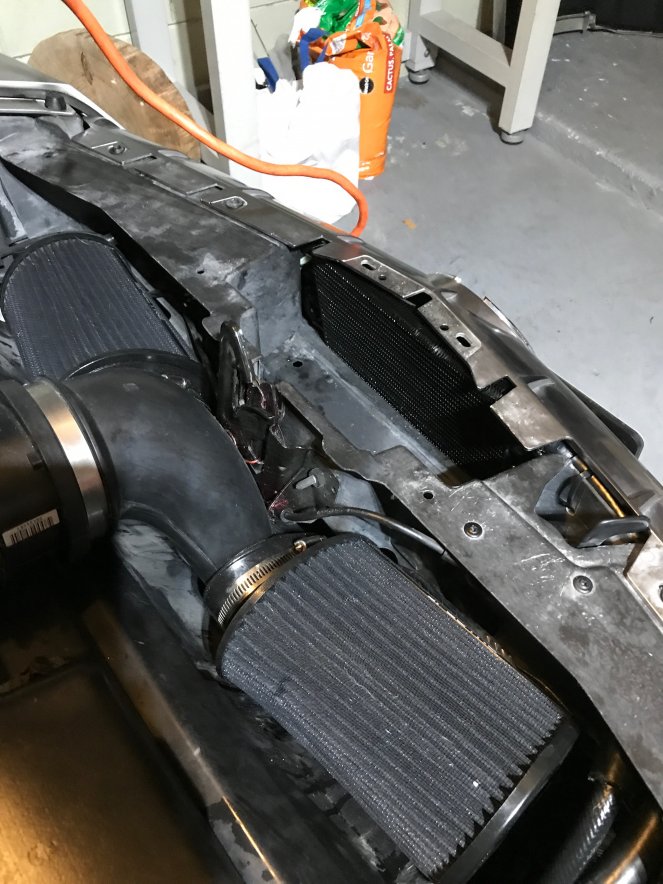

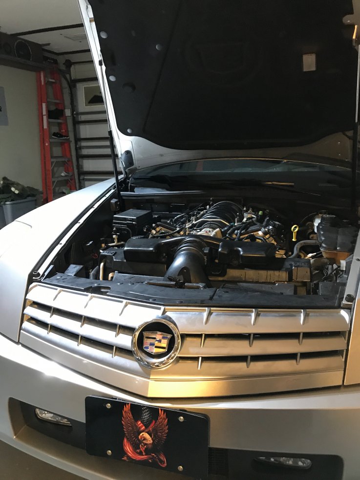

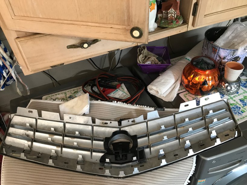

62035881921__C9394587-E9FE-40C2-B235-702BA2211ADF.jpgTake the grille off and remove the hard black plastic attach to the grille hard to explain it but you will see , this is going to allow air flow to the engine compartment. My 2005 XLR never reach 200° after I removed this piece, also I install a power steering cooler . Yesterday 95° + Florida .IMG_2737.jpgIMG_2742.jpg62035958523__7AAA1553-4253-48A0-A57A-8DAFC5D218DD.jpg

I really would not consider removing the grill inserts. First if your radiator is clean externally and a/c condenser is not clogged up , you get plenty of air flow when moving. When stopped the fan will draw plenty of air across the cooling system. If these are not working properly your car may run hot. Also I have seen dozens of cars without the rubber airflow diffuser behind the lower grills. these are most important as they guide the air into the duct to cool the radiator. Without either side or if they are loose and flopping air bypasses the radiator . they can cut down airflow 20-25% . Removing the grille inserts just gets more air to flow into the engine compartment. With air come rain water that will go right into the air breather assy as the filters are exposed. in a good storm you could get enough to lock up the engine. also the air and water mix will run under the hood and saturate the no longer available heat pad on the hood. Gm design works well, just everything has to be working and clean. water wetter is a good product and used in a lot of performance cars.
