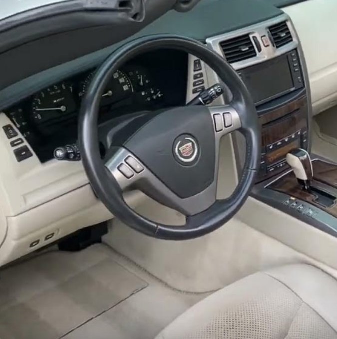

STEERING WHEEL
Most cars have a color-keyed steering wheel. Why do a few have black wheels even with light seats? And those appear to be missing the wood at the top of the wheel. Pic attached.

Im not sure about the wheels. I have a couple of all leather as shown for 08-09 and i have some with the matching wood. I think one of them is not heated. Really not sure. Look forward to someone who knows .

I read that when the V came out in 06, they had problems with the wheels zebra wood cracking due to the heated steering wheel. So the produced without the wood trim till they came up with a solution in 08 I believe. Supposedly they offered a discount or to replace the steering wheels at a future date. Most I’m sure were never replaced.
Thanks for the wheel info, folks!
