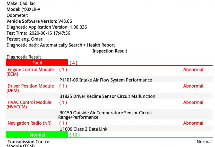

Ok, since the sensor itself was not the issue, I threw on the Tech2 and found the following issues.

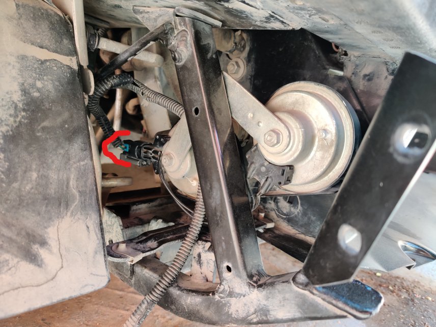

So there's an issue with the circuit, apparently. I also realized, the two horns are on the same harness, and I think my high note horn is not working. (whichever the one is to the back is, not working). The real question is, what and how do I go about fixing this?

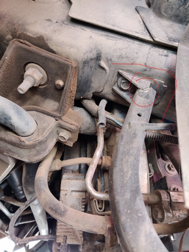

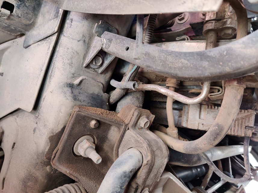

While looking at the horn harness to make sure the 10mm bolt had clean contact to ground, I realized that my skid plate must've been hit before by the previous owner. I can see cracked joints where it is actually held to the chassis (underneath and surrounding the main radiator).
Now the real question is, are these contact points for ground?
This high note horn connector is loose, and will work when I move the cable. A tech looked at it and told me it was a bad horn, as these are the symptoms bad horns give, don't know if that's true.
