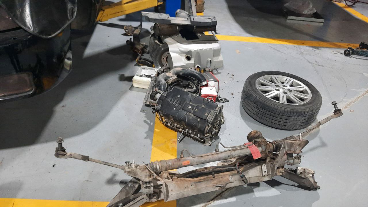

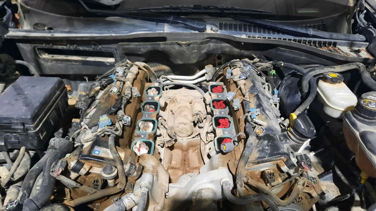

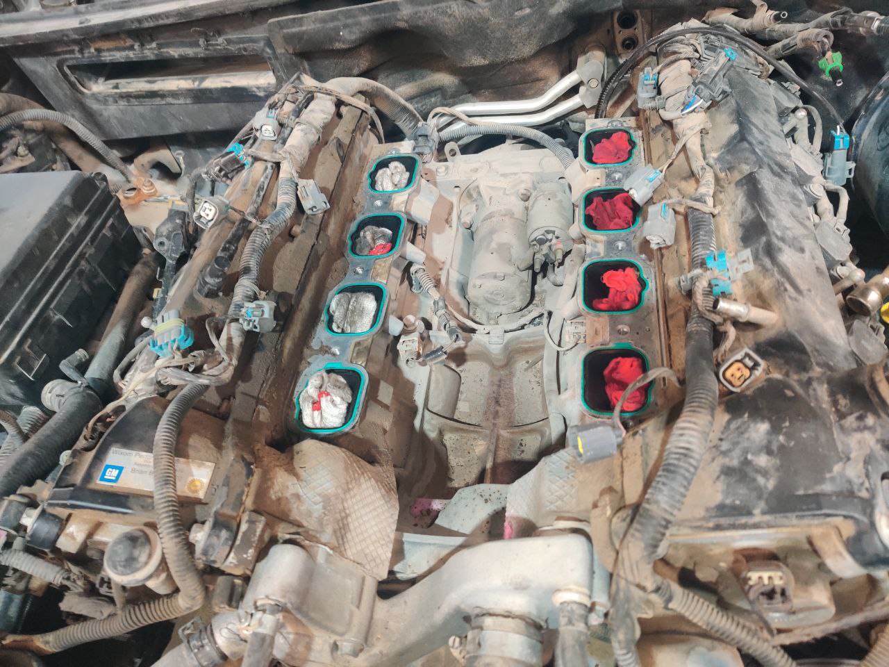

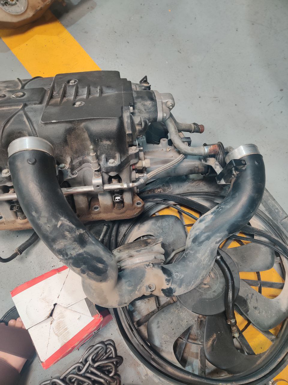

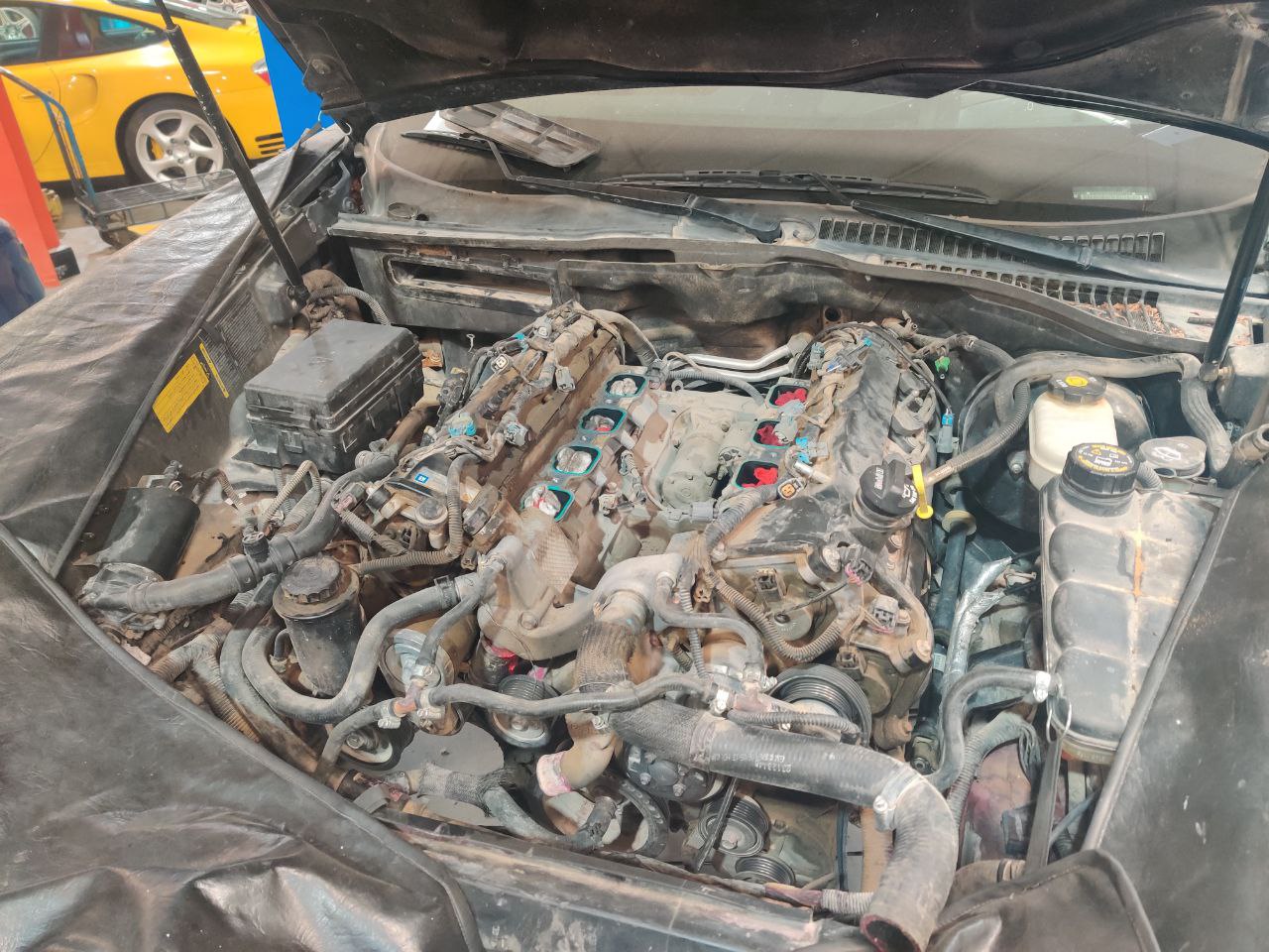

After purchasing a '13 Porsche Panamera GTS, it became my daily driver and it was time for the XLR-V to receive long due treatment and pampering.
Took it to my trusty corvette mechanic, who's worked on another XLR before and know their C5-C6 cars in and out.
The plan was to refresh the car mechanically and switch old gaskets and clean up the bay area. So a list started to form!
- Valve cover gaskets
- Supercharger gaskets
- Engine mounts
- Toelinks
- Radiator
- A/C compressor
- A/C, SC, Water pump belts
Here are part numbers which fit my 2007 XLR-V.
This will conclude the major mechanical parts needed.
Moving forward, need to do some cosmetic changes/fixes as well.
- Rear view mirror (aftermarket or OEM undecided). (15218748)
- Driver's side mirror, W/PWR fold (15225052)
- Upper door hinge, Driver side (15925761) since the door is leaning down.
Other fixes:
- Align passenger fender.
- Remove the emptied catalytic converters and replace with straight pipe.
- Remove mid resonators and replace with X-pipe.
- Get a better tune.
Cosmetics:
- Treat, cut and polish OEM paint.
- Install a vinyl wrap. (Teckwrap hornet Yellow, or Vivvid Piano Black)

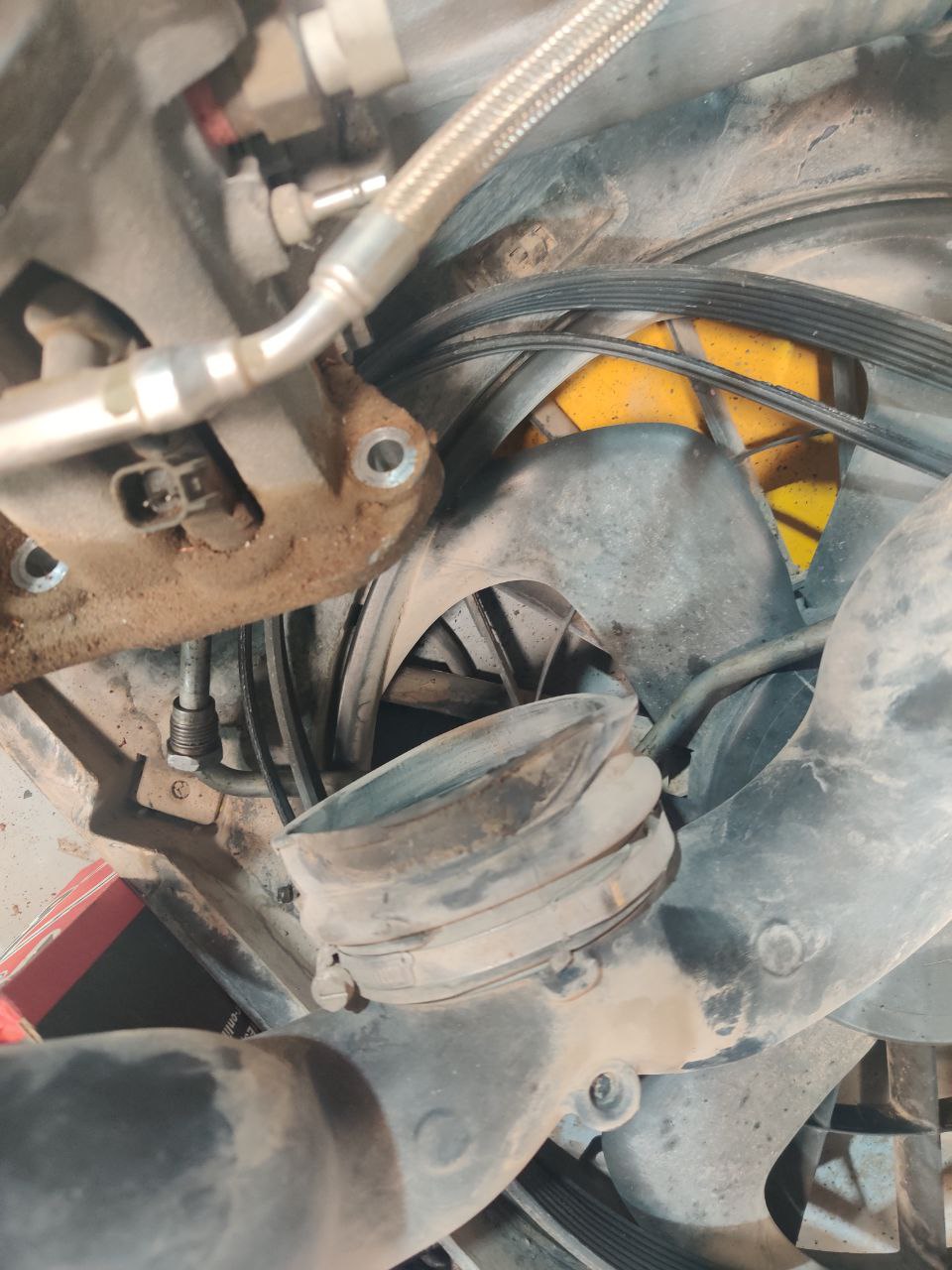

During the hunt for parts, I couldn't find 3 discontinued parts:
Thankfully a Dubai parts distributor carried the rear rubber seal (12584008), however I still cannot find the front seal duct nor the PCV tube... Hopefully universal parts can be retro-fitted in place.
