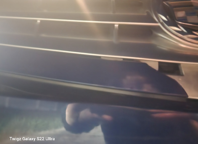

I can't find any at all anywhere except one that is in bad shape. Aside from the 09 that doesn't fit by my understanding as the 09 has a shape front end. The strip was damaged and the middle of it broke it. Now I have to say it doesn't seem molded to the grill at all. Haven't removed it but it looks and feels as if the strip will snap off. Was thinking if I have the specs I could 3d print it and paint it because it's such a minor piece.

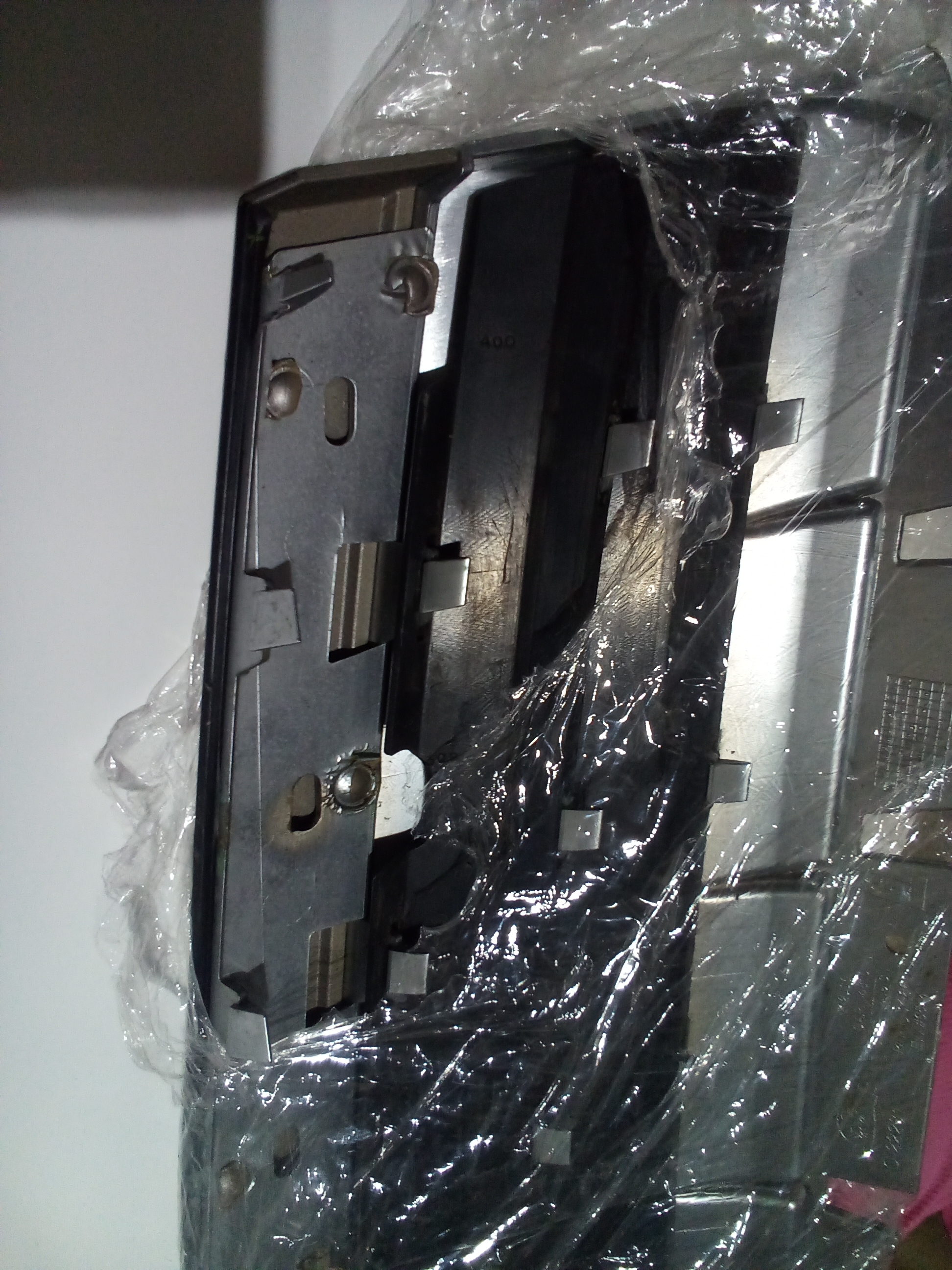

Heres a phot of the backside. The little round looking dot are the areas where the painted strip is bonded to the grille.
