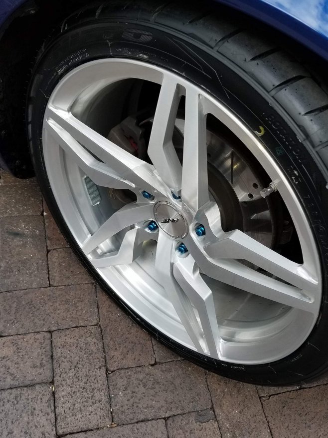

Oh, it's going to be tight for sure. There's only about 11" of room between the inner liner and the outer fender. My 285 tires are 11.4" section width. I might need to upgrade the springs to something firmer to reduce the chance of rubbing. I will also consider trimming away the inner liner and the lip of the fender well. I am hoping to do a test fit before end of week. Will report back.
