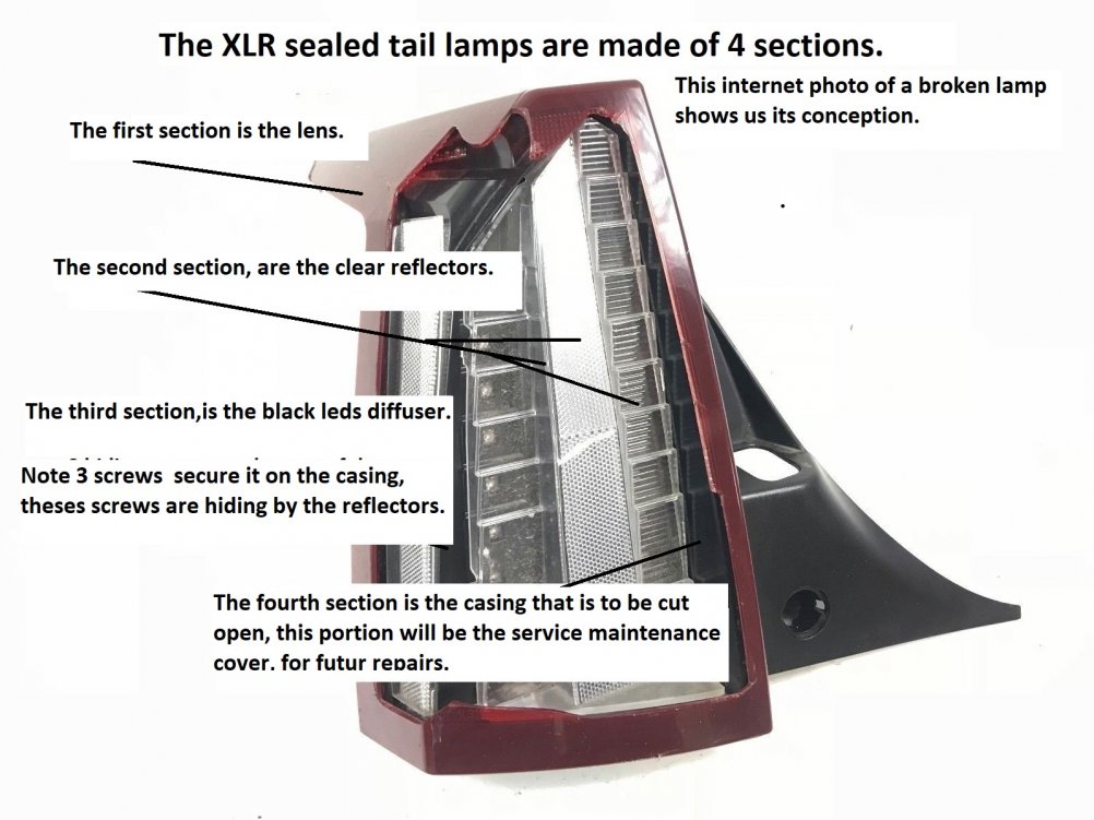

Know how the XLR tail lamp are made.
I had no choice to cut open the LH tail lamp of my XLR, the ridicul selling prices and the none credible repairs of them, in over cooking the inside vital elements and its lens.
Here is a photo from internet that shows its conception.that will help the XLR owners to understand it.

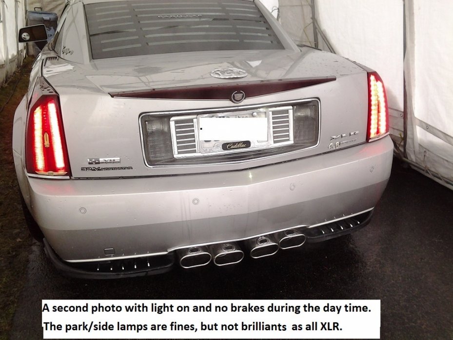

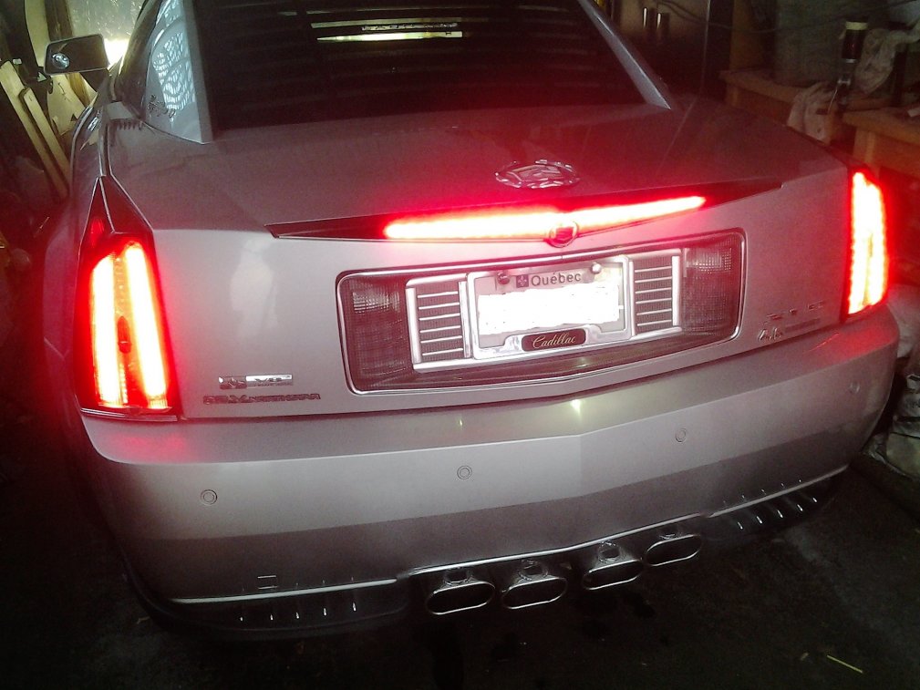

Find attached a photo of the converted tail lamp, do you see the differences….there is one but very little. the front one shows the led install 3 years ago.
20181215_153158 (2).jpg Regards

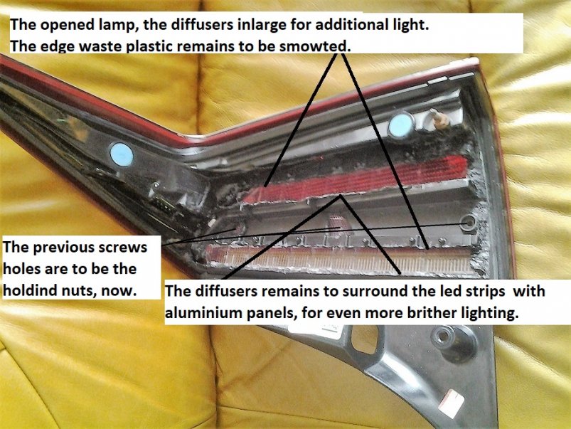

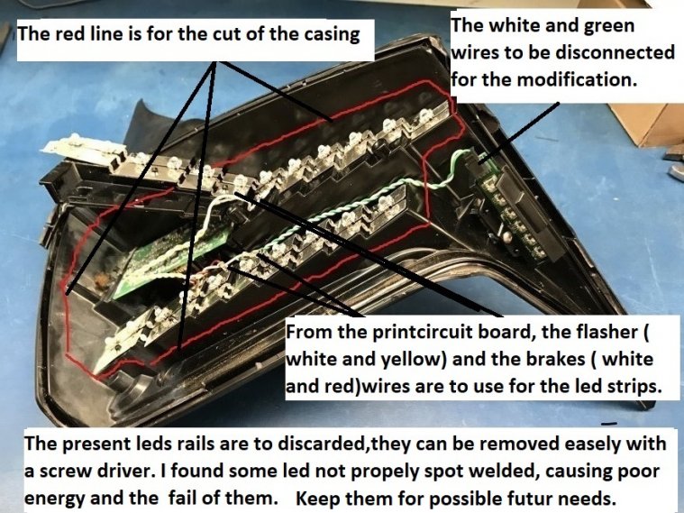

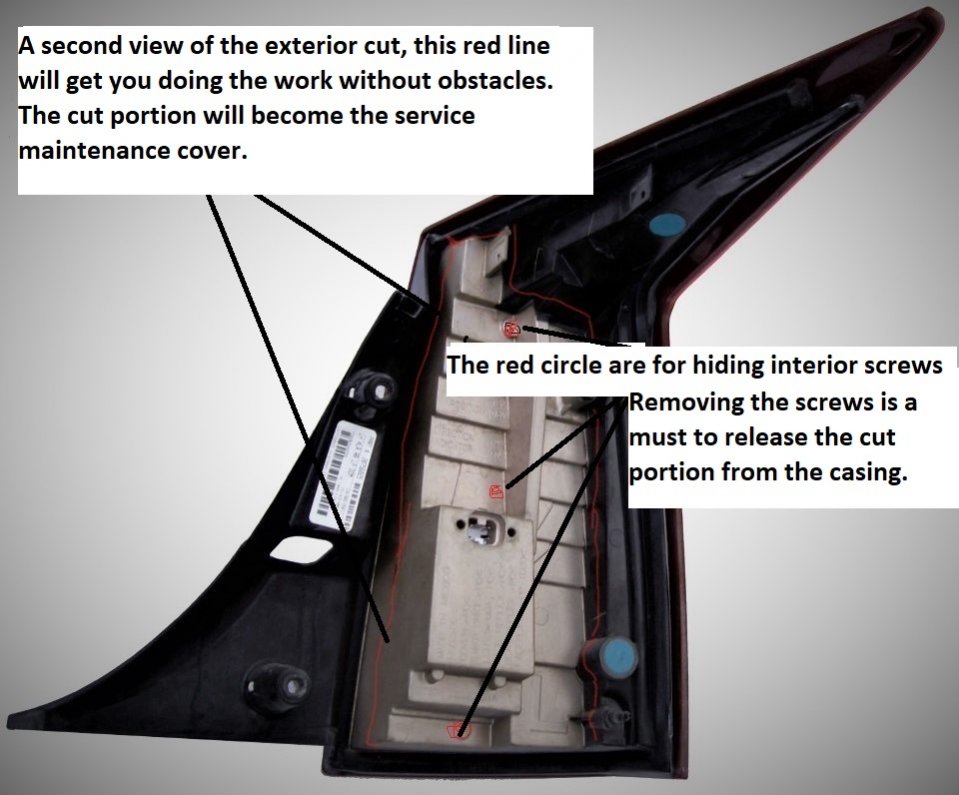

Part 2 were to cut the tail lamp.
Should you not feel good of doing it, then ask for some one who has the ability with his hand to do it
The interior and exterior photos red lines are the same one and it will guide you in cutting the lamp casing.
Get a good iron welder. when introducing the heat flat element, let it work at its speed dont push too much, relax and observe its result, having a line made previously on the casing will help you in having the iron element opening the plastic side walls, cutting it too close or to far will not produce properly the rear cover.

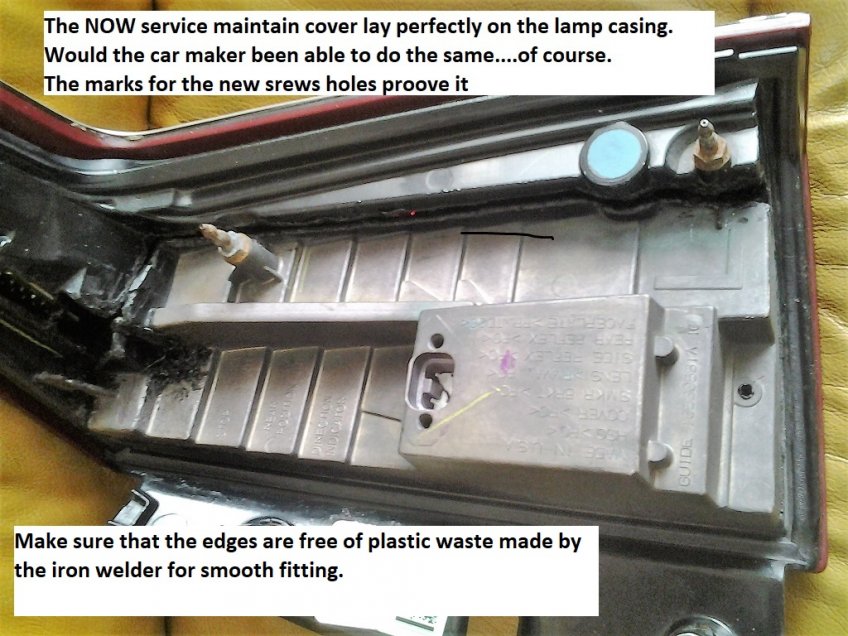

Ounce you have terminated to cut that portion, on the rear casing in the middle area are 3 round circles that indicates were the interior hiding and holding 3 screws are located, change the heat element for a round one with a small pointer, ounce inside of the casing you will find the screws end with its treads, release gently the plastic around the 3 screws treads, ounce that done you will find the release of the rear cut portion.
Those 3 circles made me thinking that a service cover was on the mind of the car producer and the ideaAA  is-mage2[1].jpgAA A 20756025-15859110-2004-2009-cadillac-xlr-lh-rear-taillight-tail-light-lamp-20756025-1585911.jpg was put on the shelf.
The cutting is the most hard part to do, but not that hard, watch your emotion when you will see your achievement.
The cutting produce wastes plastic on the edges, you can heat them and remove them with a good plier, remove them and save for other repairs welding as the plastic is quite soft for welding.
I Think that is enough for now.

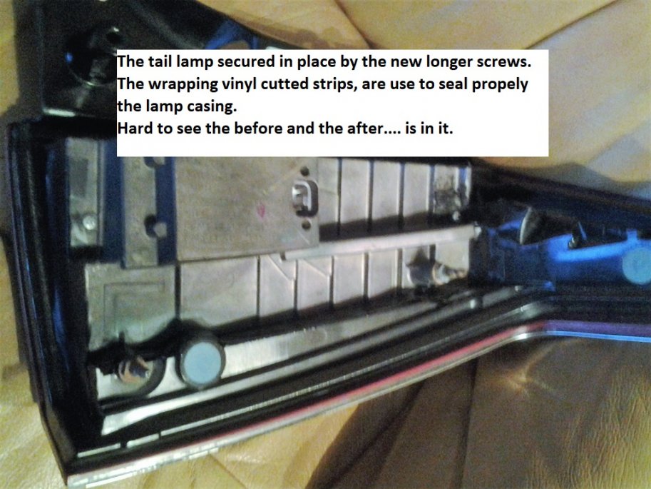

The cut lamp is sealed with wrapping black mat vinyl witch it integrate perfectly with the walls plastic.
The part 3 will be showing it.

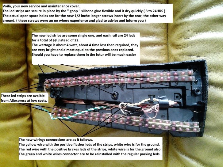

Part 3, led strips.

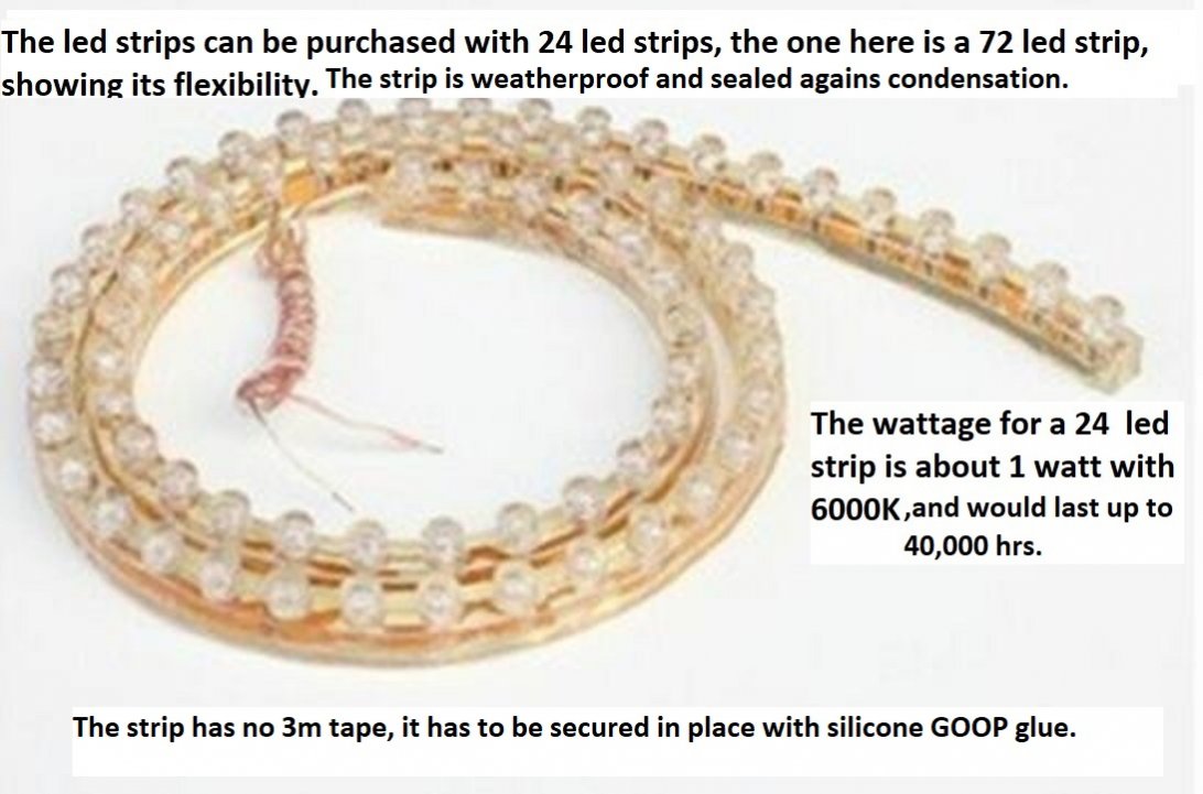

Before deciding for the strip i have try to weld some new leds on the old rails, however the tinny copper rail covered of some type aluminium were not compatible with the solder, finally i was able to do it, but after doing the testing most of them have burn out for too much hi temperature.
Regarding the OEM leds are some kind of dual led with a flat plate and weld by some tiny spot weld, the long rail with 12 led its first 6 were partly holding on; due to poor welding i suppose. then i decide to go for the B plan.
The led red strips that i used are flexible weather seal and made of silicone, so instead of having a sealed tail lamp its the lead it self who are sealed, so the result would the same.
The strips used are of 24 leds and dual strips were stick side by side to replace each rail previously discarded, each strip are of about 1 watt, so the requirement for brake lights is 8 watts and for the flasher 7 watts, finally the total of 4 watts for the 4 strips are very safe.
Regarding for the brilliance of strips the leds are good for 6000K, the lamps instead of having 22 led now has 96 single leds so the results is all most the same as with my RH tail lamps, the photos send yesterdays shows it clearly.
The led were secure in place with a silicone ''goop '' glue, a layer was put on each inside corners of the cover, the glue gets dry after few hours and totaly dry after 24 hours, the flexible glue can some how be remove for maintenance.
Would the leds last long, my experience with them in building cars, i would say of course, would it last longer then the one of the GM car supplier, i would say there is strong chances, as we all know now as owners, that the xlr sealed tail lamps do not last the life of the car.( fake reputation )
For me it is urgent that the 2004,05,06 gets attention to stop their ''decadence'' and value of this fine car, the supplier had it easy and no one ask them help is in it. Something that all we should have a reflection.
AAAA  20181211_104312.jpgAAAAA  20181211_104222.jpgAAAAA 20181211_104424.jpgAAAAAA 20181211_161037.jpg
