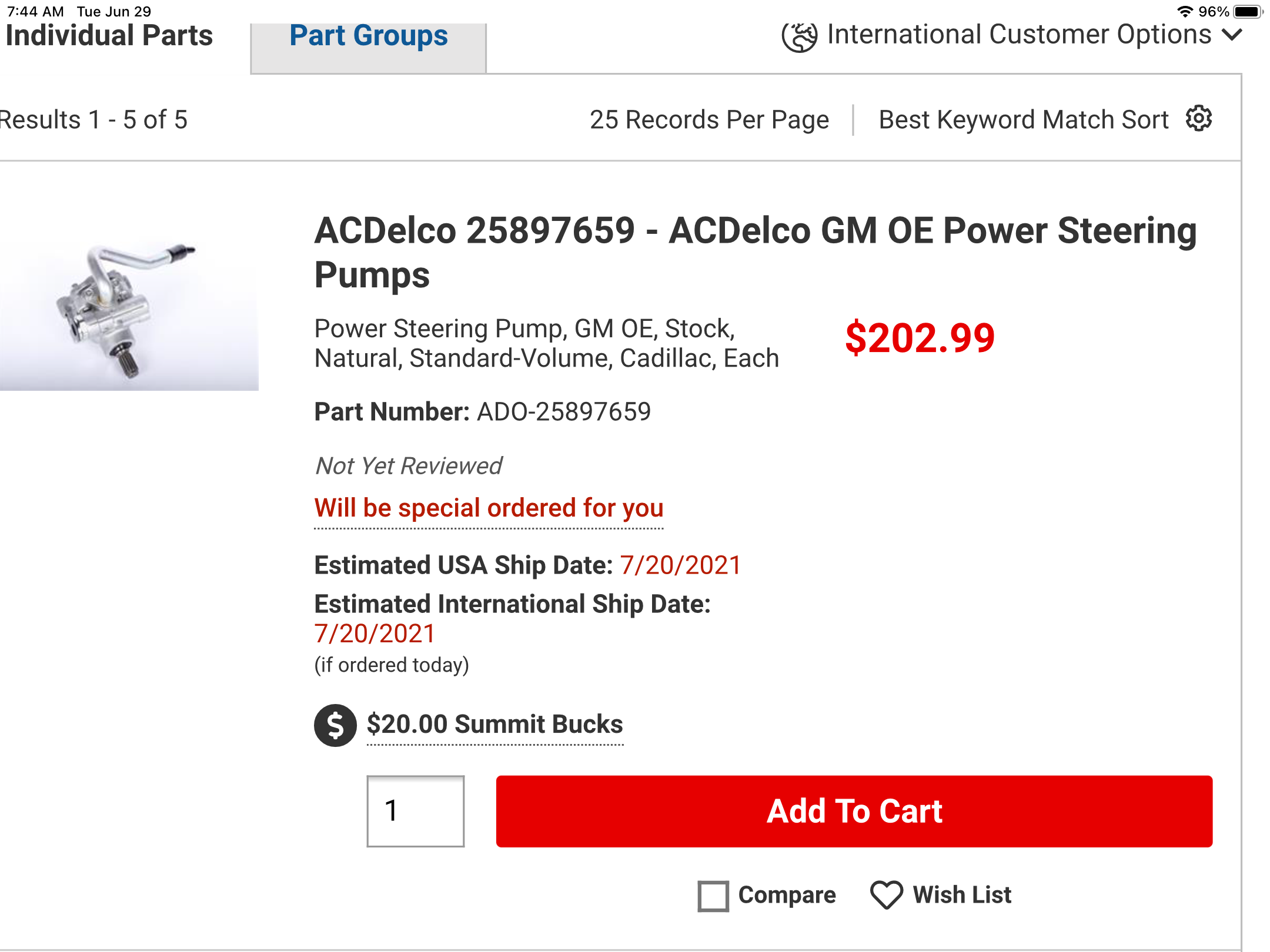

25897659​
V uses a splined pump shaft. Part number above. Going to be hard to find. Maybe summit racing will back order it for you but may take a while.
So to update this thread, I cannot find anyone who can rebuild the power steering pump. Part # 25897659. So it is ordered from Summit Racing for around $350.00 Canadian. Hope tghis helps others. Only concern is the delivery time is 6 weeks, but better than nothing . I cant drive the car without it.
well hate to burst a bubble but I had already called them and a/c delco. Discontinued with no new production in line. I was going to order maybe 2or 3 to see if that would help get them to make some. Looks like only option is going to be having someone that knows what they are doing to rebuild it . Of course they will have to make the parts needed so Thats going to be in the 1000$ range I would estimate. We will watch to see what you hear back from Summitt. I am looking at the corvette pump from the supercharged car and none seem to be splined so I wonder why they felt it was needed on the XLR_V. I think you are going to have to buy something like the holly aftermarket pump and get it adapted to fit.

I also ordered one from Summit last month. I called today, and there's no indication it will be available anytime soon. They offered me a refund.

Sorry to hear you had the same problem as me. Michael was able to help me. I should have done that 8 weeks ago. Summit let me down. Don’t waste your time with summit / AcDelco. Just my advise. Good luck.
