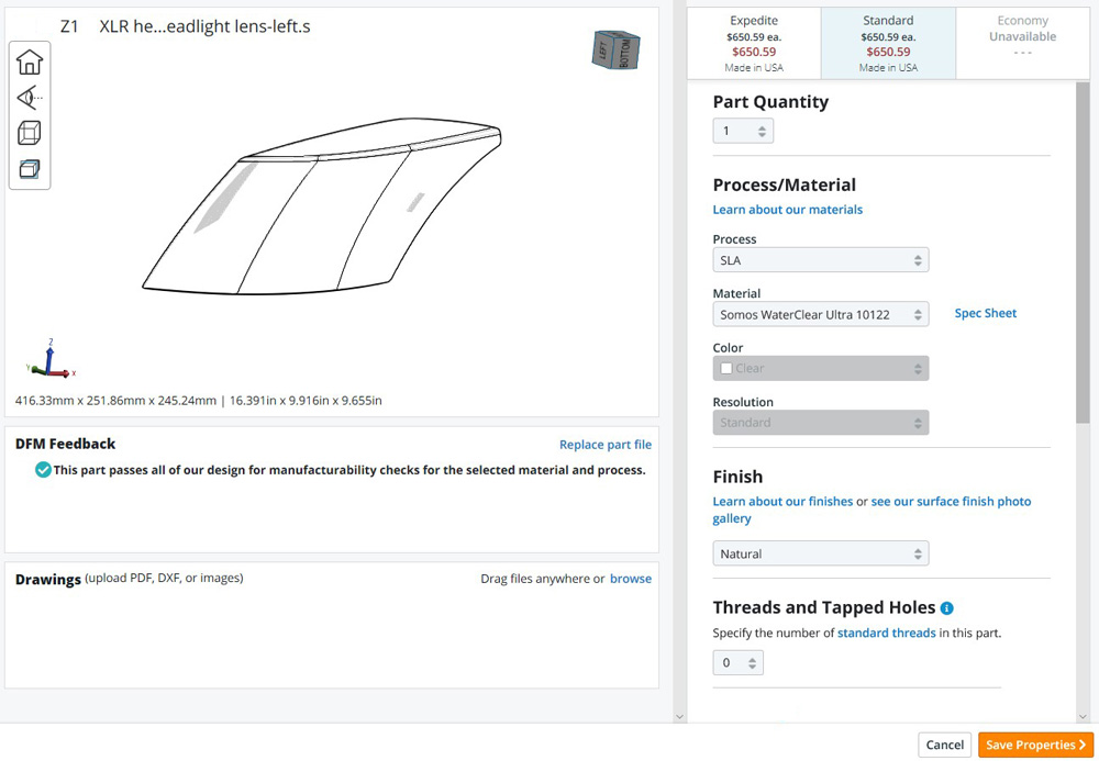

I am now able to 3D print headlight lenses with Somos Waterclear Ultra. The heat and UV issues of previous materials are gone. Printed lenses now has the same properties as OEM.

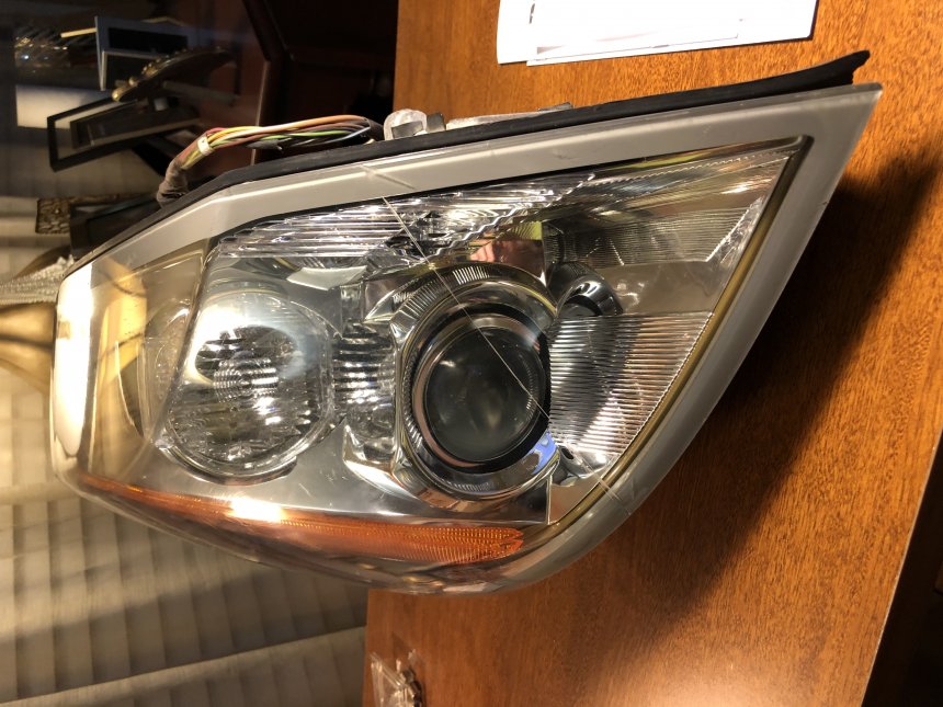

I have a right side light with the other lens scratched. Is this what we are talking about? If so, how much to replace the lens?

Yes, We are talking about the outer lens which is where you scratch is. I personally would sand and polish it, if it's not cracked through. That's a nice headlight.
I can't give you quote i
f you did want the lens replaced,
because the printing costs are always changing and I don't know if you are going to do some of the replacement work or you want me to the work.

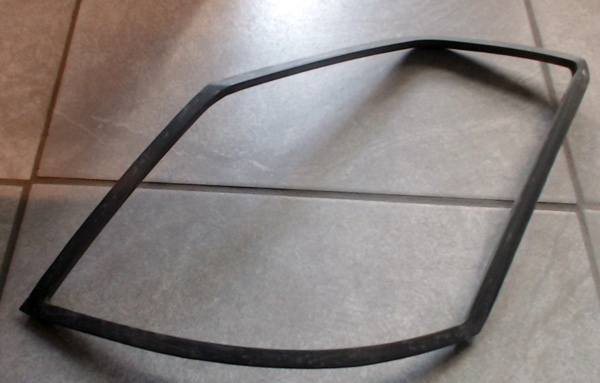

The first pic is of the outer lens gasket. It's very f*cking real and made out of a different plastic then the outer lens so it must be made in a second print which is costly. Then you have to use a special plastic glue and combine the two pieces. Very hard to get to look right and very f*cking hard to not make a costly mistake.

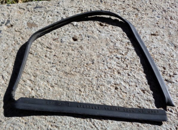

The second pic is of the rubber strip. Notice the many bends and shapes in it. It's very unique and very visible when the headlight is installed in the car. It's so unique that GM gave it it's own part number: 16530915. I dare you to get that rubber strip at some butt-hole parts store for 10 and it not look like a piece of sh*t let alone wrap around the headlight properly.

The picture on the left is called a lens reinforcement by the people that manufacture them it is not a "lens gasket". It is a plastic part with a very high failure point. When heated enough to remove from the main housing the reinforcement will break into parts and will release from the outer lens. That is why it is necessary to install the outer lens to the reinforcement the same way the factory did . especially since you want OEM equivalent .the "rubber seal" you show on the right is indeed a seal. . And yes it would be hard to make but they are just glued to the headlight and almost never are damaged. I have maybe 50 of those if anyone needs them just ask. no problem. They shrink a bit over time and I remove them and apply a process that swells them back to proper size then reinstall. 20 minutes time tops. The headlight lens reinforcement on the left which from the factory is green/gray is bonded to the headlight main housing by the butyl kits that I said are 10$ and I am correct they are less than 10$. the outer lens is bonded to that reinforcement by a special process that you will never duplicate in a workshop. Even Gm's re- attempts performed at million dollar facilities failed miserably when they tried again in 2013 and cost them close to 20,000 recalled and trashed headlights. I do not need nor welcome your language. it kills any sort of professionalism you might try to portray I will continue to work on my lights that totally satisfy me and my customers. Good luck and I hope you are able to come up with something that benefits the community. I still am looking to buy the outer lens when /if you ever make any. all the other parts are already in full supply.
