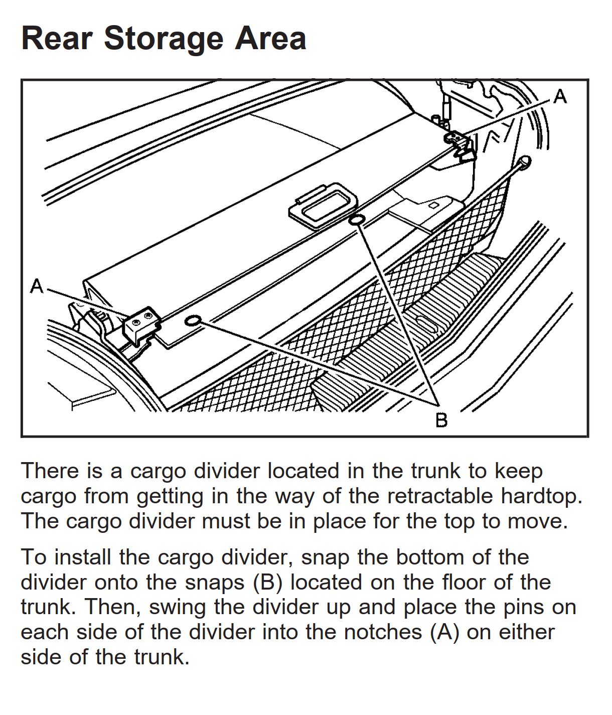

Your top issue may be REALLY simple-- there's a " removeable bar/partition" that extends the entire width of your trunk. In order for the top mechanicals to engage, that bar MUST be securely placed in the brackets on both sides of the car-- if it's not fully seated, nothing will happen. I hope this is your problem. ALso, you need to know how to use the emergency door release handles -- it's possible to get locked in the car.

Someone else responded about the top, but to expand on that, there's a cargo divider in the trunk that has to be in place in order for the top to function. See attached image. You will find this detail in your owners manual. If you don't have an owners manual you can find a PDF copy online by searching "2004 Cadillac XLR owners manual PDF"
