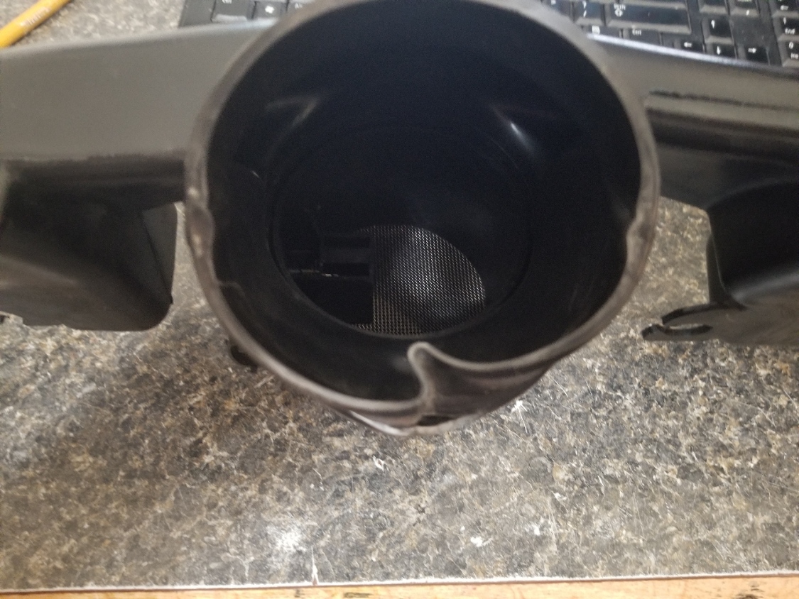

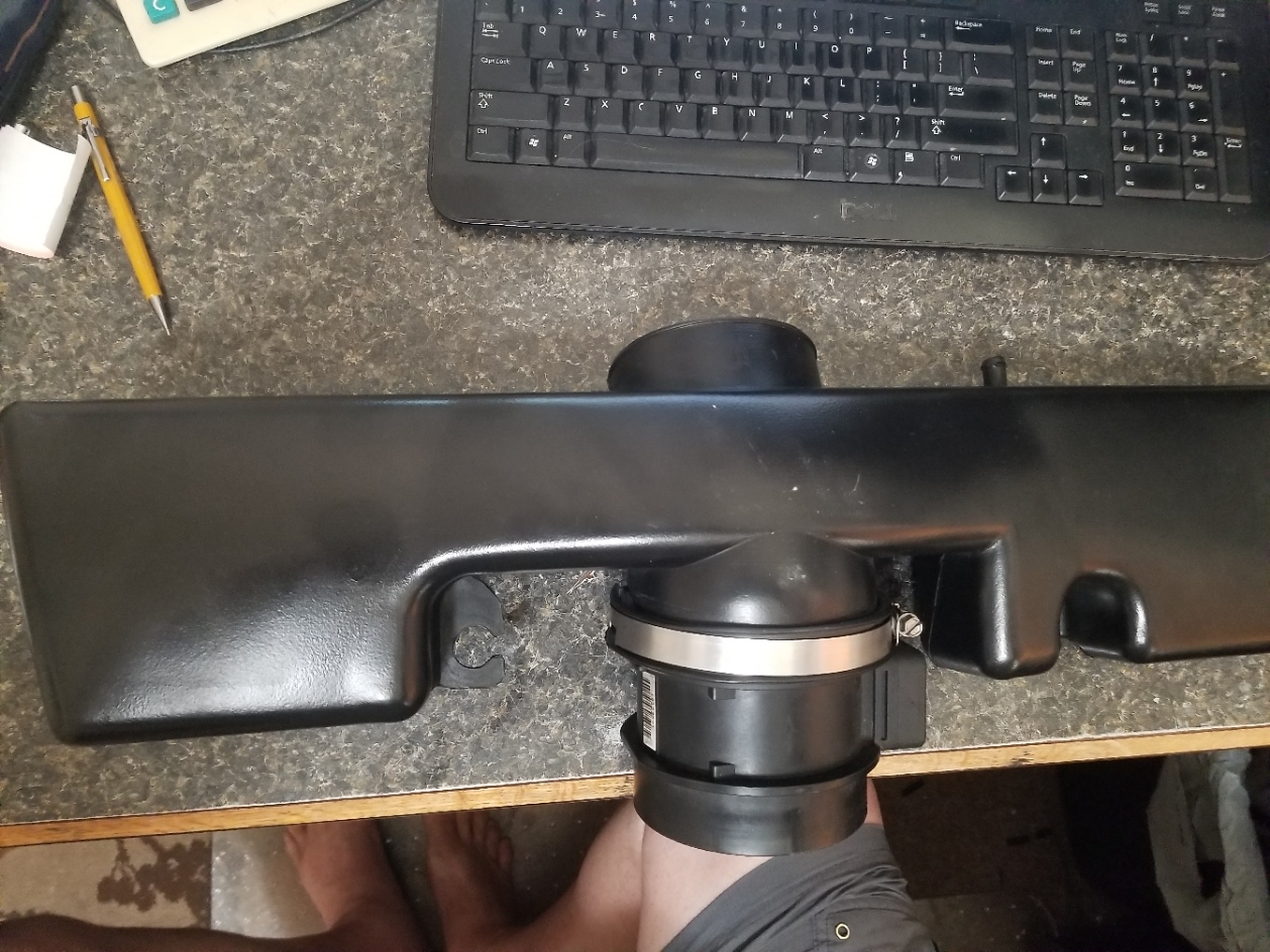

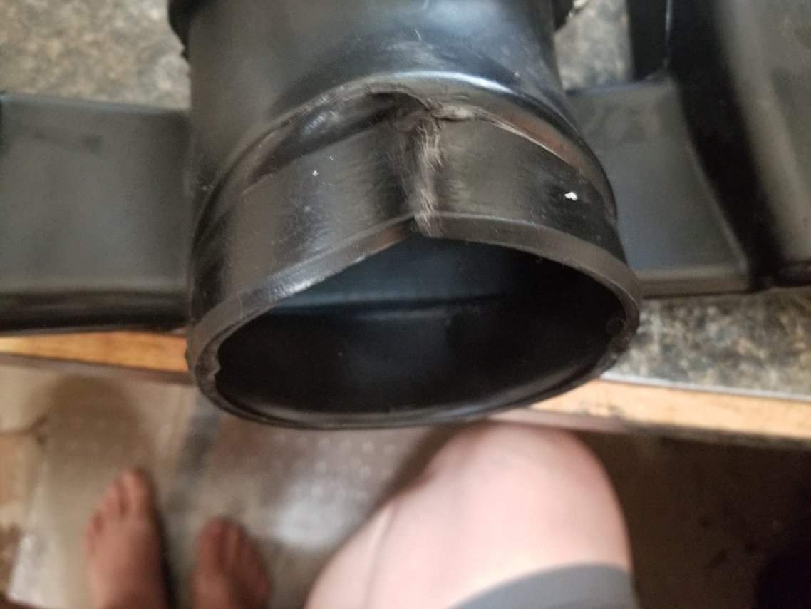

I (thought) I had found what was causing mine; removed all ducting from the filter to the throttle body, replaced filters, MAF, MAP, and if like mine the air diffuser (some anamal had crushed the bottom opening) then finally the throttle body and gasket removed the fuel rail cleaned the injectors and new seals, removed air plenum new gaskets and retorqed the bolts replace the dirty line at rear of plemum, installed new spark plugs. Now spent $$$ at the ACdelcotds site trying to reprogram. Took it to my mechanic tells me I might need a catilyic converter and did not reflash the ecm lets see $500 in parts 4 hours labor still have the codes. After all the expense and time found the problem I had purchased a MAF that was listed that it would fit a 2005 it did not, the 04-05 uses a differnt one smaller in size! Replaced it with a ACdelco and problem went away.
Base 4.6L or V 4.4L?
Sorry bout that I have a 4.6 base here is what I was writting about located at bottom and the rubber sleeve going to the throttle body worth checking out this connection requires sliding the rubber over the top using something to lift the rubber over that edge

No reason to be sorry, I really only asked for folks who come across it in future searches.
