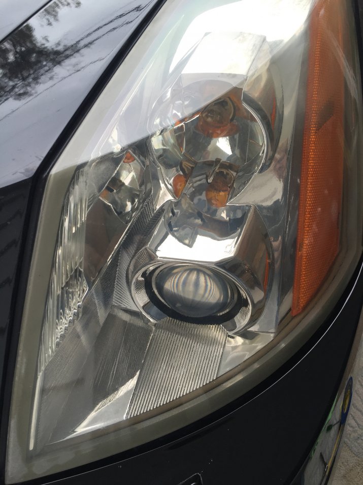

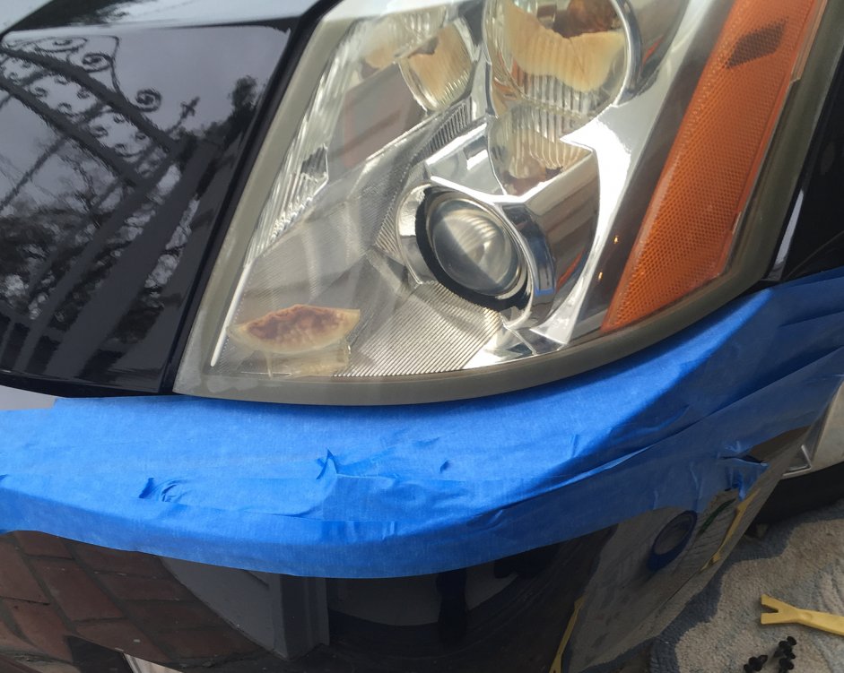

Until I can get new headlights here's an option IF your DRL lamp plastic light diffuser is melted or has partially broken off inside the light housing.
If you follow this procedure do so at your own risk... and remember these lights are hard to find.
Protect your bumper!! I used some painter's tape
After removing the DRL lamp it's possible to reach through the hole and knock out the melted plastic insert. The melted / brittle plastic lens will break apart easily with a pair of long needle nose pliers and the pieces dropped out.
So does the bare bulb look better or worse than the melted lens insert? Well probably not but this is going to have to do for a while.

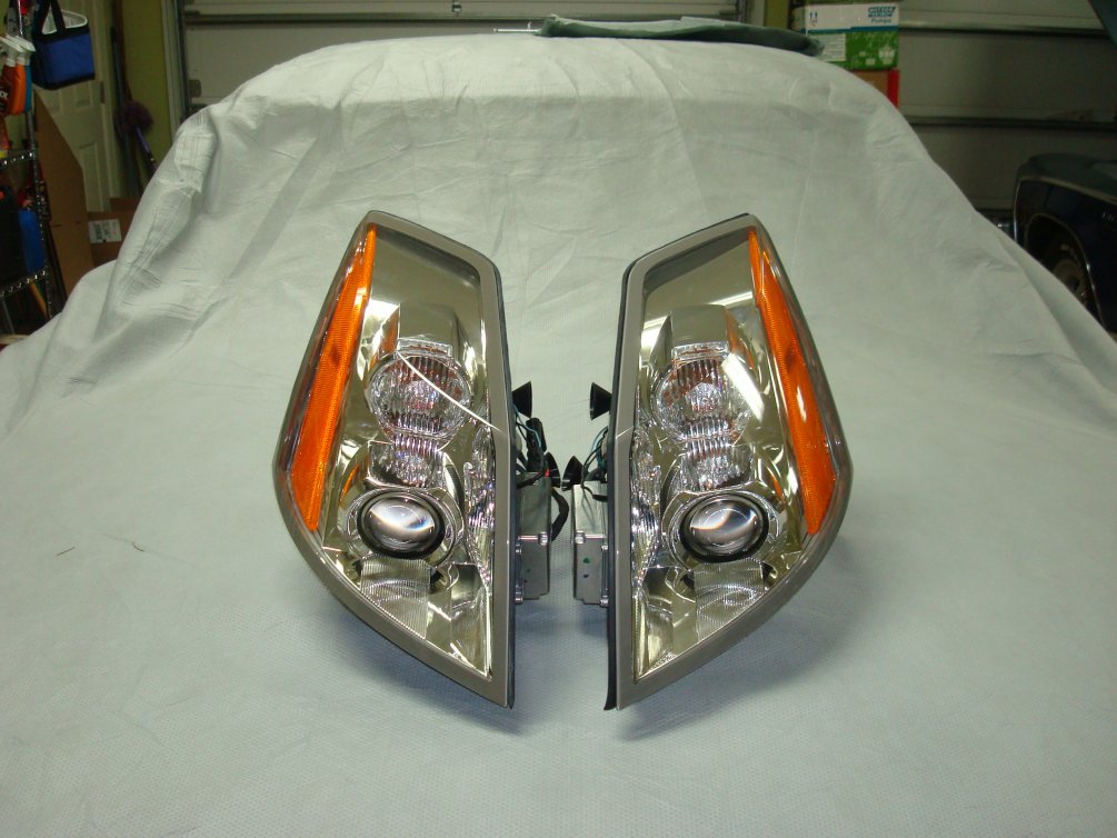

Aren't they pretty?
Very pretty, don't you think?
Not teasing
Now you're just teasing us. Is that your spare set?
My purpose for posting was not to tease, but to show that these are real units that are available. Not cheap, but I don't know what they sold for when they were available from GM.
Yes, they are my spare set. It is somewhat ironic that the factory set in my 2005 XLR are near perfect, with no crazing or burnt spots. It just seemed to me that in the event of a collision, the probability of the headlights being damaged is high.
While I'm not trying to build a new XLR "one piece at a time", I have acquired a few items likely to fail or need replacing in the future. I have a serious track record of keeping my favorite vehicles for a long time (see my garage). My XLR will be no different, I plan to keep it for a very long time!
By the way, I would be tickled if GM would produce new copies of the headlight units. It would benefit the greater XLR community! If I don't ever need them, I will be just as happy!
