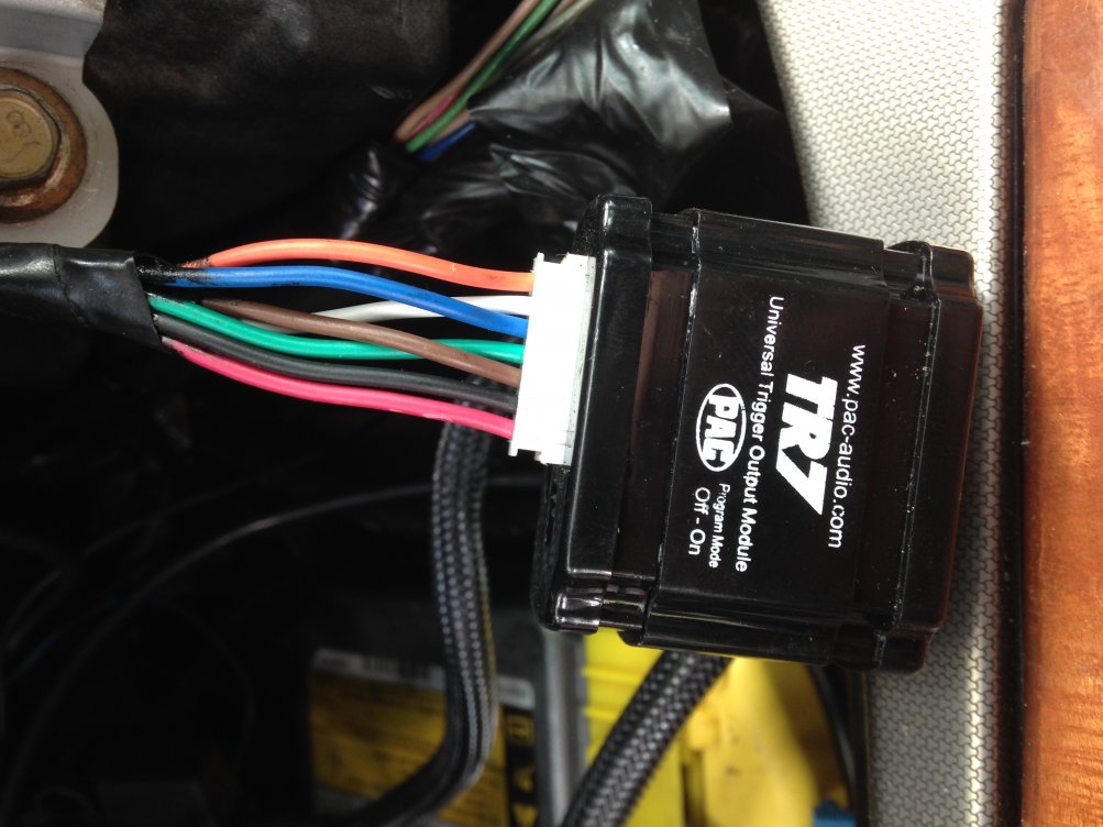

now that I'm posting, though, I wonder what that TR7 trigger in al_jazz' car is being used for…

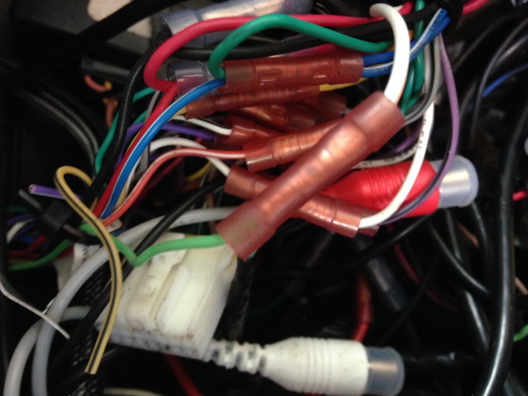

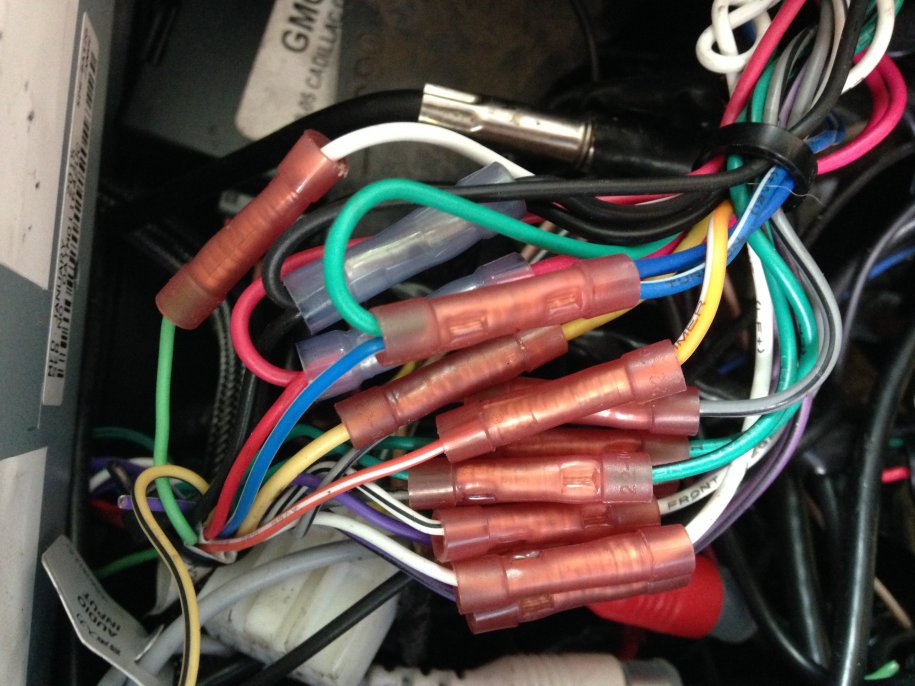

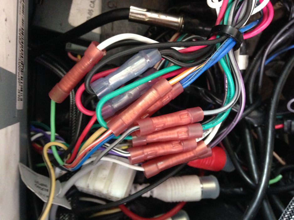

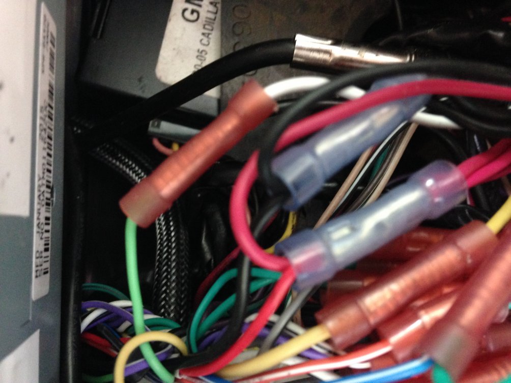

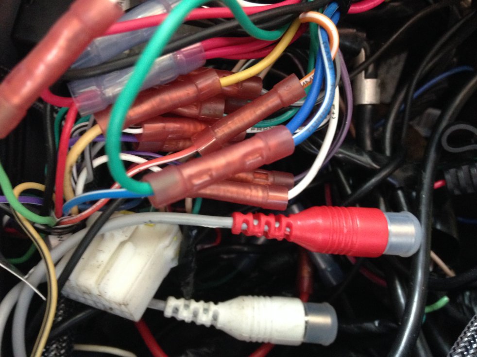

Ok...before I delivered her to her new owner today, I took the dash facia off and took some additional pictures. I think I have the answer to the trigger questions.
The TR7 trigger is hooked up in the following manner:
Orange is not used
Green goes to blue with small white stripe
white goes to small light green
Red to red
black to black
That should provide the trigger you need for the Bose Amp to engage...
