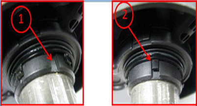

    20009 Cadillac XLR - #PIC4930: Audible Click Noise When turning The Steering Wheel Left Or Right
  2. Refer to the image above. Inspect the vehicle to be sure the Steering Wheel Position Sensor (SWPS) is installed correctly. In call out number 1 above, the SWPS is not installed correctly. Note: the SWPS has a tab that should rest in the opening as called out in number 2 above. In call out number 2 above, the SWPS is installed correctly. Note: The tab of the SWPS is secured in the opening. If the sensor is found to be installed incorrectly, remove or rotate the sensor so that it is installed correctly as shown in call out number 2 above.
